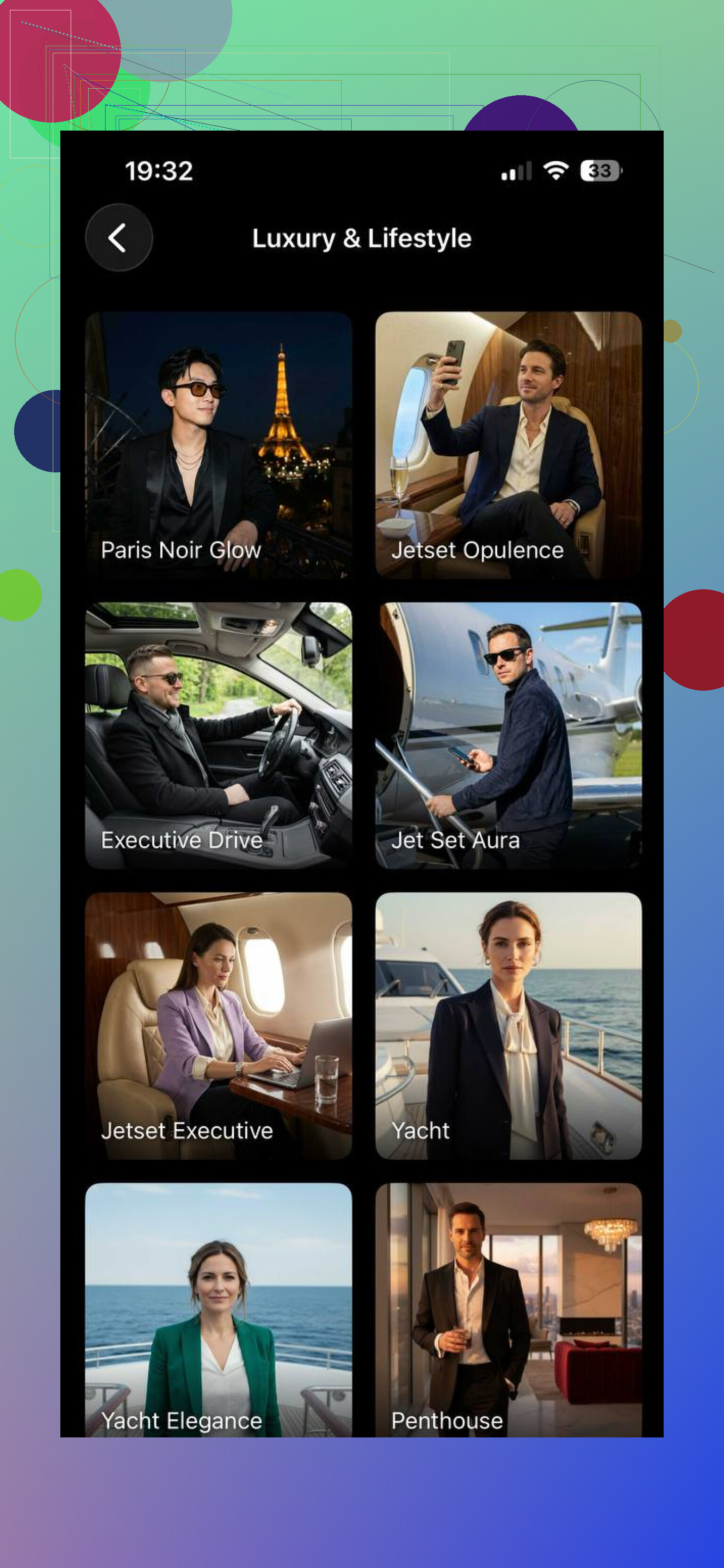

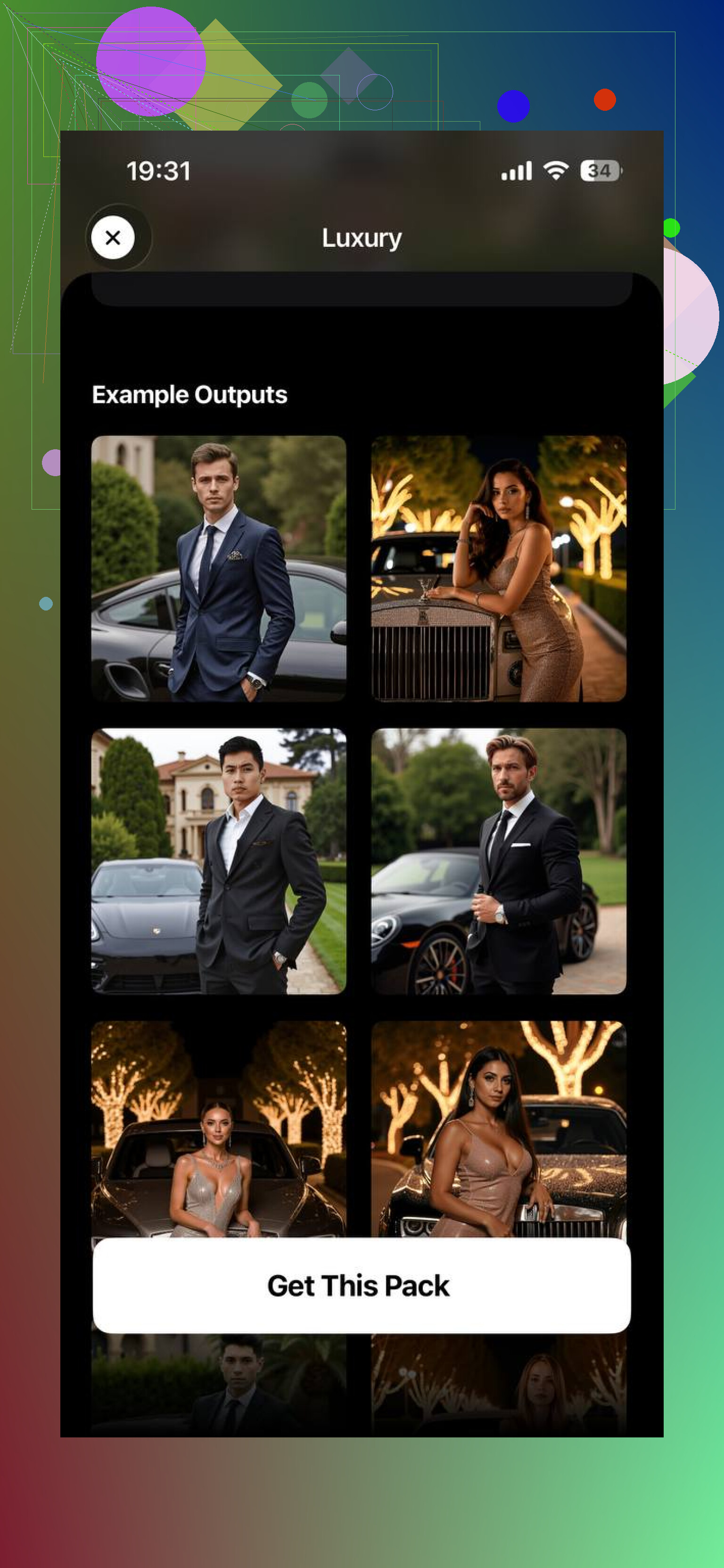

I tried a few of these portrait apps after getting tired of the same flat selfie look. In 2026, the whole thing feels almost too easy. You upload a handful of selfies, wait a bit, and out comes a set of images with expensive-looking outfits, polished rooms, rooftop views, hotel-lobby lighting, the usual luxury setup.
If you want the short version, the one I kept going back to was Eltima AI Headshot Generator app . The name undersells it. I expected plain corporate headshots. What I got was closer to full lifestyle portrait generation. City backgrounds, dressed-up casual shots, fashion-ish frames, cleaner upscale indoor scenes. It handled those better than I thought it would.

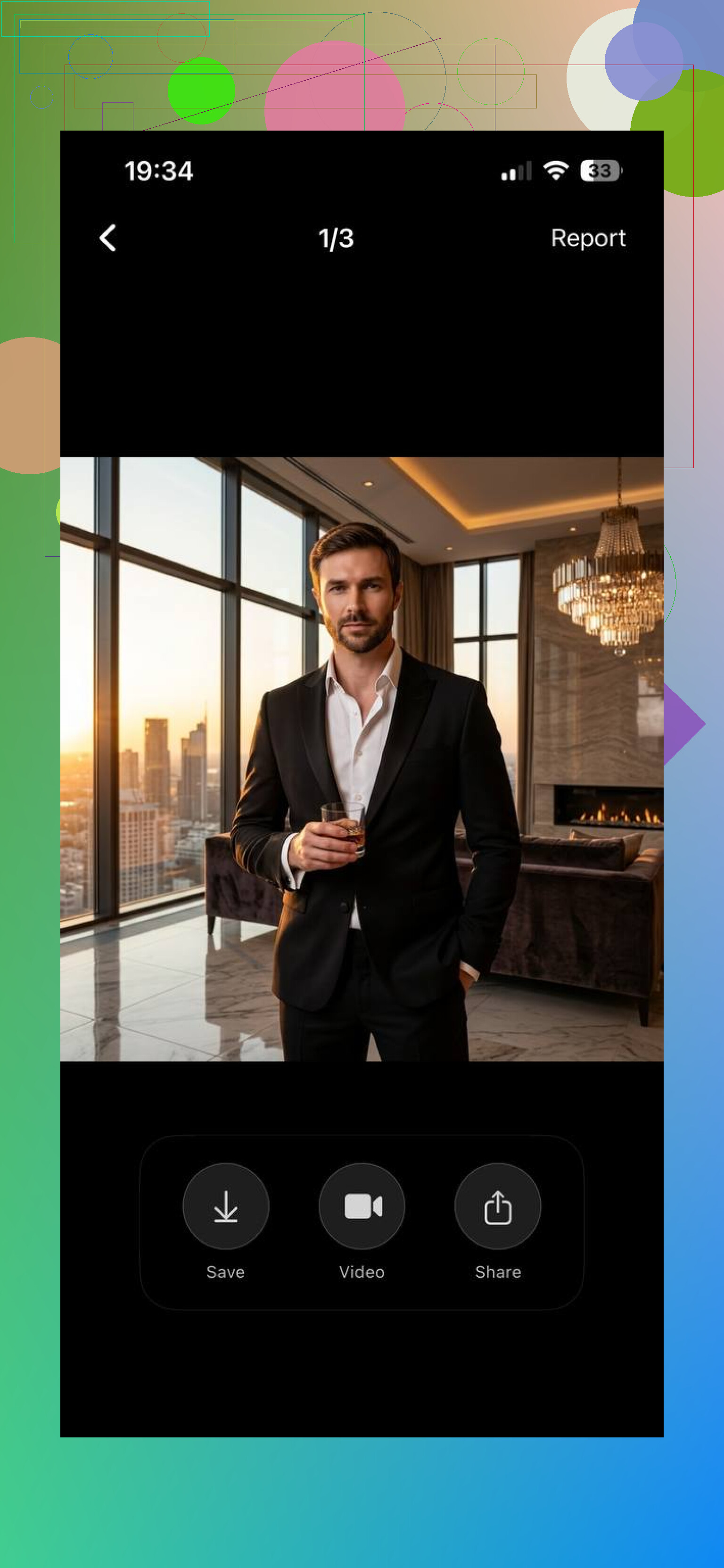

What stood out for me was face consistency. Some apps give you a different person every fourth image. This one stayed closer to my actual features across different looks. The skin didn’t turn plastic. The jawline didn’t randomly shift. Eyes stayed like mine, which sounds small until you test a few generators and see how often they miss it. The photos came out polished, but not in a weird overprocessed way.
I also tried MoMo AI. Different vibe. It leans harder into trendy presets and social-style glam shots. If your goal is attention-grabbing images with more flair, it does the job fast. I got some nice outputs from it, but a few looked too filtered for what I wanted. Good for aesthetic-heavy posts. Less good if you want people to look at the image and think, yeah, this seems like a real shoot.
So if you want luxury lifestyle portraits with a cleaner, more believable look, I’d start here: I’d start with Eltima AI Headshot Generator. It gave me more range than the usual headshot-only apps, and the results felt closer to a full photo session than a gimmick.
